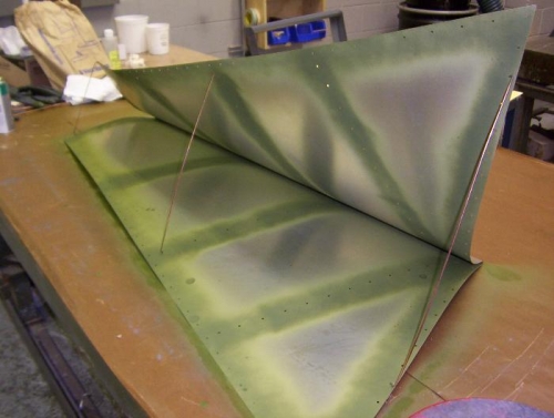

Brief Description:  Remove Marine Zinc Chromate

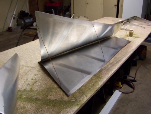

The Marine Zinc Chromate in the rattle can didn't stick as well as I thought it should have and it was covering more area than necessary, so. . . I decided to remove it with Laquer Thinner. Had to be very careful with the skeleton and only used a moist rag rather than a soaked rag. Didn't want the thinner getting between the areas already riveted.
The Skin Weight before removal was 3 pounds. After 2 pounds 13oz.
Skeleton weight before 1 pounds 10oz. After 1 pound 8oz.
I will weight them both again when I brush on the Self Etching primer.
Before

After
