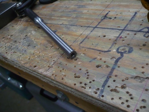

Make boring bar to size distributor bushings

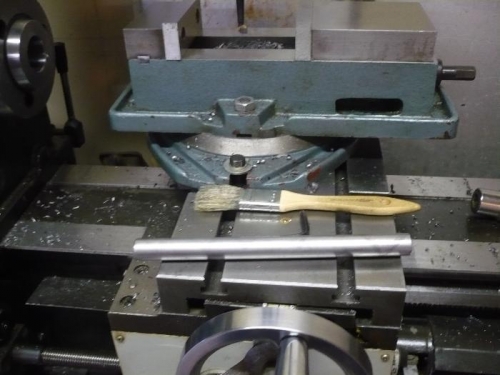

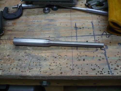

Make boring bar for distributor bushings from 5/8" drill rod. Could find one long enough to do the job.
Turned shaft down to .4" OD, drilled and tapped 8/32 hole in end to retain tool bit.
I will drill a 7/16 hole in the bushings and start boring from there.
