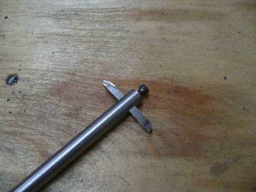

Make boring bar to size distributor bushings

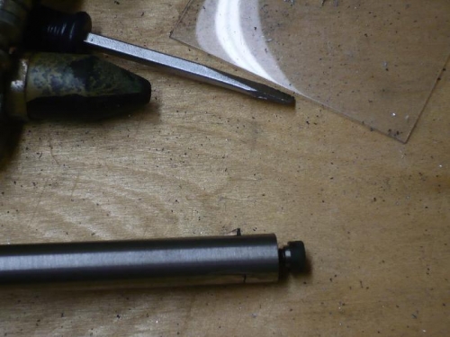

Drill 3/16" hole for tool bit through center of boring bar.

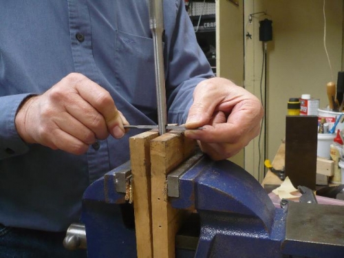

File the hole square so the tool bit just fits.
Sharpen bit and trim off extra length.
File hole square
So bit fits through
Trim tool bit
