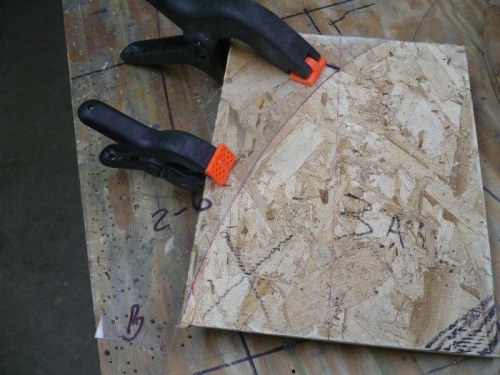

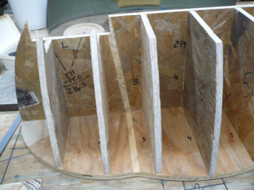

Brief Description:  Layout transition stations

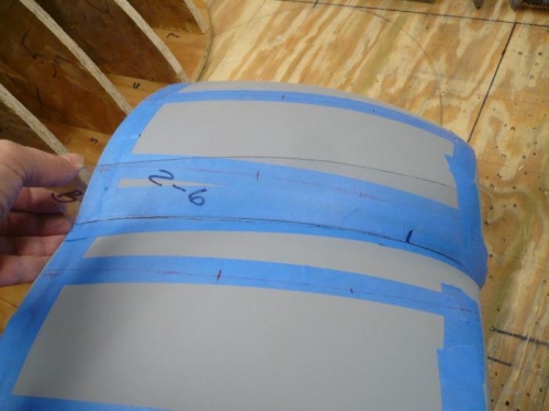

The shape of station 2 & 6 is the same as this line to the point I marked on the template.
Cut and squared transition stations. Routed recess for the transition stations. Picked up height from base and height from split line from the part and transferd that point to the transistion station.
Lined up the 2-6 station template at the base and the point to transfer the line to the transition station.
