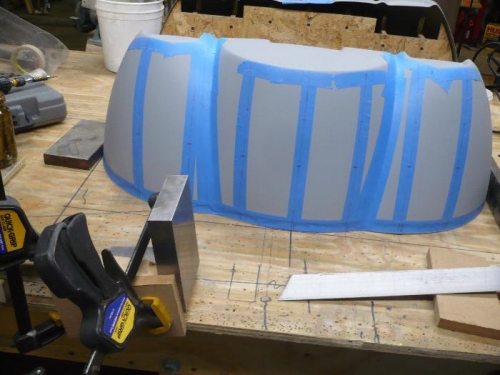

Manual Reference:  WW Nose Bowl

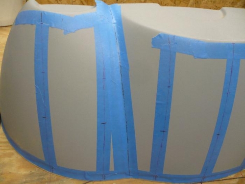

Brief Description:  Layout transition line of shapes.
Position angle plate to the transition line of the two shapes. Keep angle square to table edge and place shims under angle to sight the best angle, clamp it in place.
Draw line on tape for where to pick up the contour.

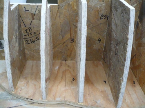

Exchange part for station buck, line it up to the marks on the table. Transfer line to station buck.
Repeat process for other side.
