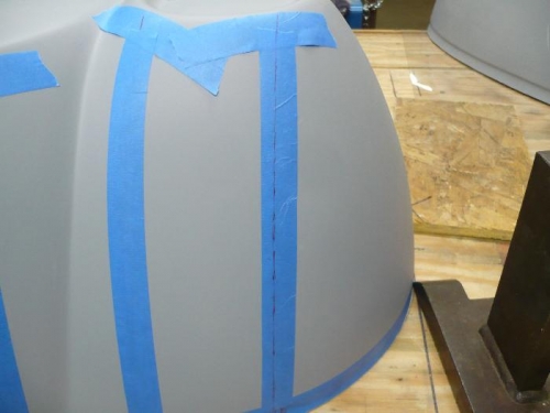

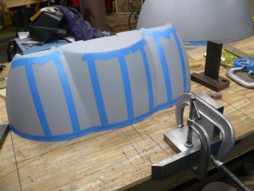

Brief Description:  Grid bottom to transfer shape to stations
Layed out same 100mm grid lines on the table then transfered it to tape on the top nose bowl at the bottom of this view. Placed tape sections at the top and marked the 100mm grid lines there. Then strecthed straight lines of tape, the verticle lines top to bottom so I would have something to draw the line on without marking the line on the part.

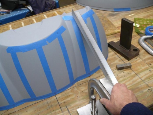

Clamp angles in place on the table and extend the line to the part with a straight angle in segments, about 1 ince or less at a time. The only thing that touches the part is the pen tip. If the part moves it gets reset.
The line is the shape I want on the stations.
