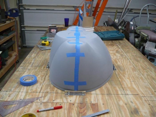

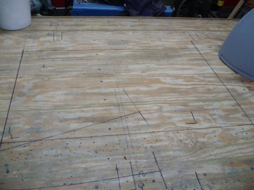

First drew box 33" X 21.5" on the table.

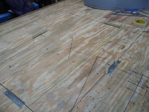

Added supporting L-Angles at stratigec locations, center line and split line and screwed them to the table. I put tape on the face of the angles to not mark the nosebowl.
Used blue painters tape to mark centerlines and to hold the nosebowl together.
It's pretty stable but I might put in some cross bracing to minimize any movement.
drew box on the table
painters tape holds it together
