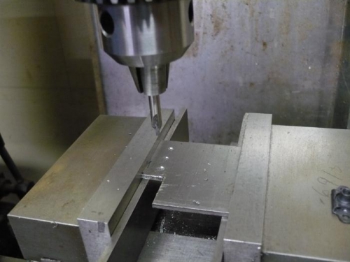

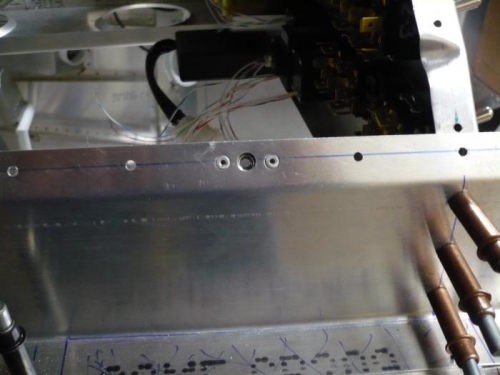

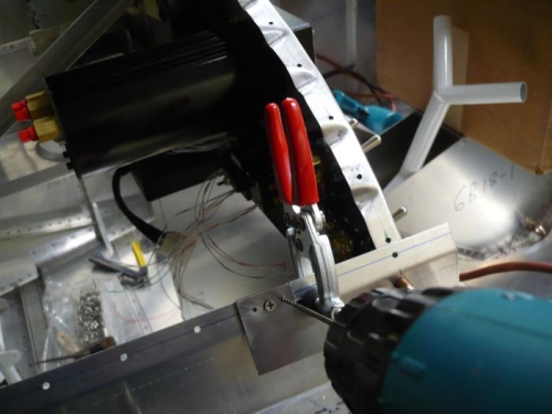

Make tool for nut plate hole spacing
Acuratley space the holes. For these plates the hole centers are .6915" to the end holes and the center is for the screw. Threaded the center hole to 8-32 and use it as a locator drill guide.
