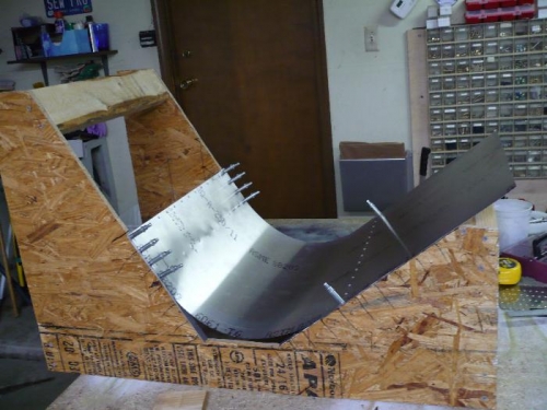

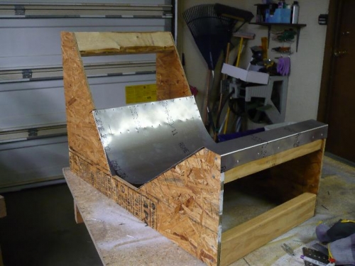

Seat buck
Cut some scrap angles from the old wing spar and screwed them to the wood form to hold rivets of the cover skin.
Cut more scrap wing spar angles to run crosswise inside the fixture. Cut .016" sheet to form over the fixture and riveted it in place.
It won't support my weight but it will give me a close enough lay up and layout fixture.
