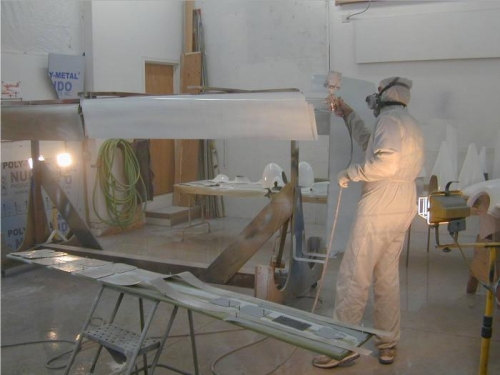

Brief Description:  Epoxy primed FG parts & tail feathers
Epoxy primed all F/G parts, flaps, ailerons, rudder and all inspection covers and fairings. After 3 hr cure, wet sanded same parts with 500 grit paper.
Scotchbrighted Vert Stab and both wings.

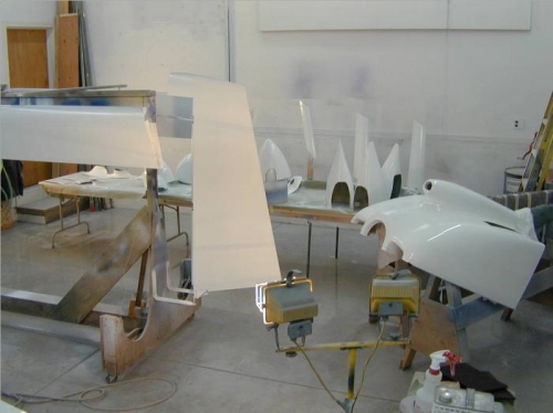

White base coat applied to F/G parts, flaps, ailerons and inspection covers.
Epoxy primer being applied to flaps
White base coat applied for first time.
