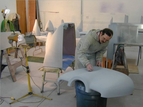

More sanding & scotchbrite metal parts
Wet sanded all FG parts with 500 grit paper and inspected for pin holes. Any holes found were filled with Evercoat fine filler then wet sanded out.
Scotchbrited out flaps, ailerons, rudder, Horiz Stab. Cleaned parts with a solvent metal cleaner.
This was wet sanded with 500 grit paper. Inspected for pin holes which were filled with Evercoat fine
