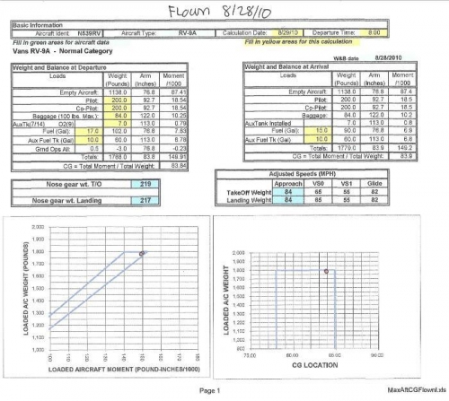

Brief Description:  15th flt. Max Aft CG 83.8" flown (3 flights total)
3 Flights.
Loaded airplane in various configurations to acheive GW 1800 lbs and also CG of 83.8".
Made a total of 10 take off and landings to evaluate low speed handling.
Use of 10 Deg flap on take off reduced take off distance by about 25%.
Found it very easy to over rotate in landing flair as elevator effectiveness seems to produce a greater pitch response. It handles just as you might imagine where the CG and Center of Lift are close together. At this high weight and CG, making the final approach at 80 mph & 20 deg of flaps, went smoother by decreasing the angle of descent, which helped make the flareout less "dramatic". Can say I don't care for landing the airplane with aft CG... it's much "trickier".
