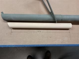

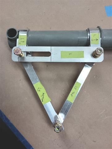

Brief Description:  Fine tuned the landing gear
Decided to fine tune the wooden dowel components that restrict motion in the landing gear assembly. Remade those that go in the bottom cylinder and cut them 0.125 inches longer. Cut new dowels for the top cylinder long enough to take advantage of all of the travel available in the link. Also added an angled cut at the top in order for more of the wood to share the landing loads (avoided a point load).
