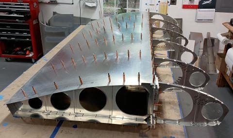

Brief Description:  Skinned top left wing panel
Rough installed the left-wing panel's top skin. Went well even considering I had to adjust the hole alignment on one rib and discovered I'll have to install shims under the skin at the last rear rivet hole to avoid a concave curve forward of the rear spar.
The skin is on!
The skin is on!
Minor hole pattern adjustment
This will need a shim
