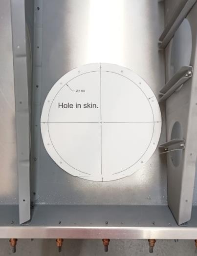

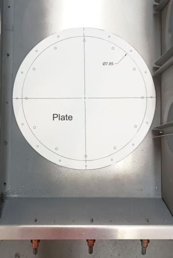

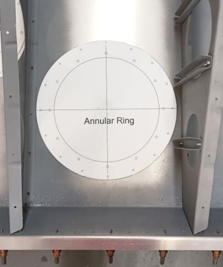

Brief Description:  Layout transponder install concept
Decided the ground plane requirements for the ADS-b and transponder antenna could be met and fit between two ribs in the center wing panel. Laid out the size of the hole that will be needed as well as the mounting annular ring and how the cover (ground plane) will fit over the ring. The files were sent to sendcutsend for fabrication.
