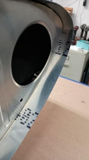

Brief Description:  Attempt to install the nose skin
The installed ribs were waiting my arrival to the shop so wing skin install started immediately. Not so fast. They still wouldn't go on but this time I stopped when the forward part of the nose rib (now the weak link in the chain) just started to buckle. All assembly efforts stopped and a thorough analysis of what was happening started. Turns out the nose ribs are a bit too long. I'll take care of that tomorrow.
Buckled nose rib
Buckled nose rib
