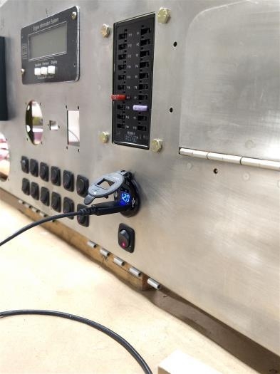

More wiring today.
Fabricated a heat sink for the Schottky diode and wired in place.
Wired the USB outlet to buss 2 (powered via the Schottky) and all went well.
Noticed that the master solenoid got pretty hot before discovering one of the terminals was loose. Will test tomorrow to see if that is the source of what I think to be excessive heat.
The USB port charging a phone
