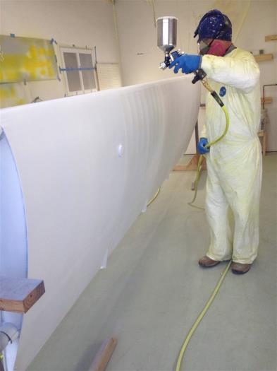

Next, spray on the last coats of primer on the right wing panel.
