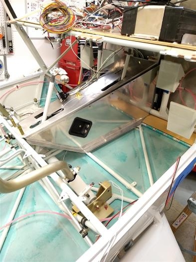

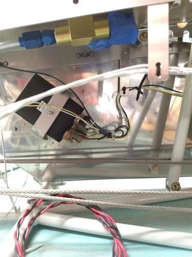

Brief Description:  Installation of the headset jacks
Well,,,,,, reorienting the headset jacks was tricky but the deed has been done!! Turns out that routing three ground wires and the audio wire was best done if, instead of going under the rudder cables, a new bracket was fabricated, attached to the flap positioning bracket and used to provide a hole thru which the little ol wires go thru. Simple and quick to type, not so much to do.
Installed the instruments into the panel. Will put it in tomorrow.
