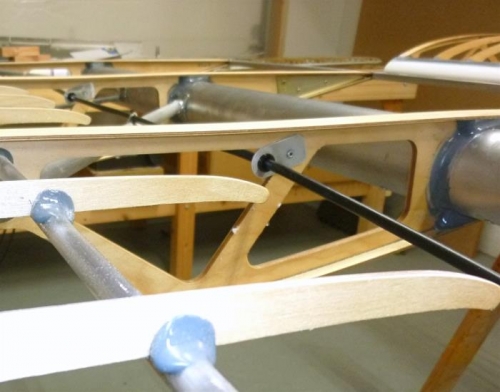

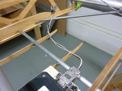

Fabricated line routing guides, fabricated pitot tube alignment guides (four each), installed pitot line, install magnetometer wiring.
Overall a pretty good day. Did run into a self-induced problem when I fabricated the pitot tube alignment guide (want to be sure that it will take extra ordinary force to twist the pitot tube out of alignment) without concern for fitting the assembled unit onto the wing. Opps. Had to fab a new mounting plate and alignment tab.

Magnetometer routing
Pitot routing
Pitot routing
