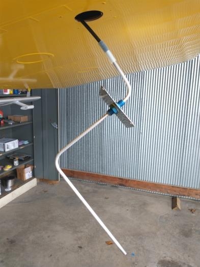

Brief Description:  Adding pitot tube and shock fairings
Decided that I'd start the winter upgrade projects by: 1. reducing how far the pitot tube extends from the bottom of the wing (as originally installed it hits the HS when the wing is folded) by one inch, 2, installing fairings around the Monster Shocks, 3. installing fairings around the pitot tube and jury struts.

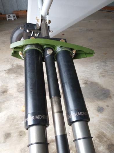

I laid out ribs for the shock fairings and Joe was kind enough to convert my 2D design to 3D and print out the evaluation pieces.
As installed - too long from the bottom

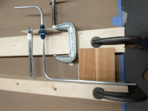

Jigged to shorten and epoxy in place
Test fit ribs on the shocks
