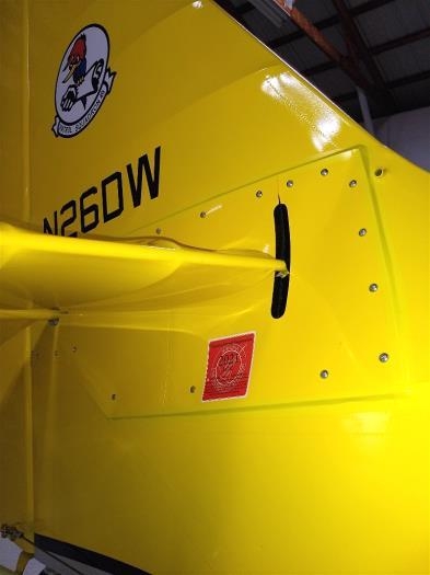

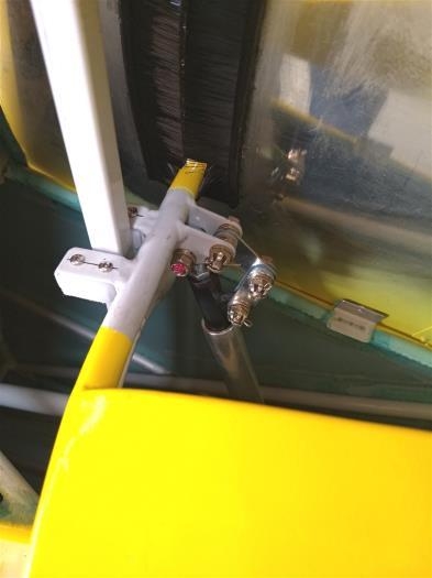

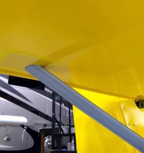

Added aero fairings to HS lift struts
Added aerodynamic fairings to the horizonal stabilizer lift struts.
Fabricated and installed close outs for the lift struts at the HS attachment end.
Also, closed out the HS trim slot with brush material.
Aero faring and close out
Outside view of brush close out
Note bolt direction on mechanism
