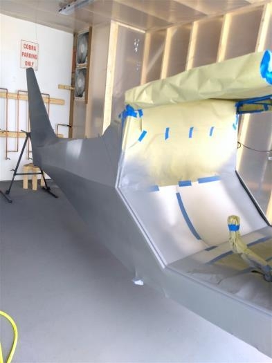

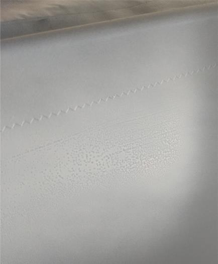

Sprayed the last coat of UV primer on the fuselage. Having done so, I was setting the gun for spraying the primer on the gear legs and thought I'd check the spray pattern on the just finished fuse. Hit it a little too hard but learned a lesson - the primer has to go on via what is basically a fog coat then the finished coat. You probable can't see the issue (major case of orange peel) in image #2 but I put it there in hopes to help someone else - no sense learning from your mistakes when you can learn from mine. Luckily it is in a very small area (see the white patch mid station on the fuselage) and can be easily sanded out.

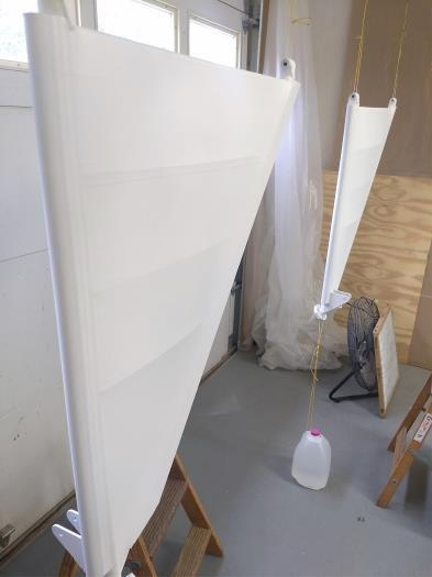

Anyhow, I then sprayed the primer on the gear legs and all went well.
BTW - you might have noticed that I decided to use one end of my shop for spray booth #2. Reason: I don't want to move the fuselage out of the real paint booth until it is done and on its legs. Too risky as the rotisserie wasn't designed for major moves.
Last coat completed

Orange peel - see description
Primer on under carriage
