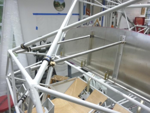

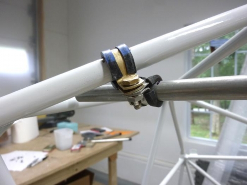

Modified the design of the instrument support braces a bit and fabricated and test fit both of them.

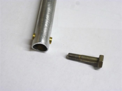

See the picture below but basically I didn't want to squeeze the ends of the support tubes and then bend them to match the firewall. So, instead I drilled and bushed the firewall end of the support tubes. Later, I fill the end with Hysol and cut off the extra length of the bushings.
