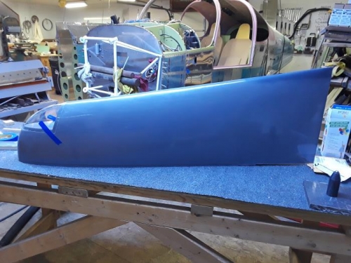

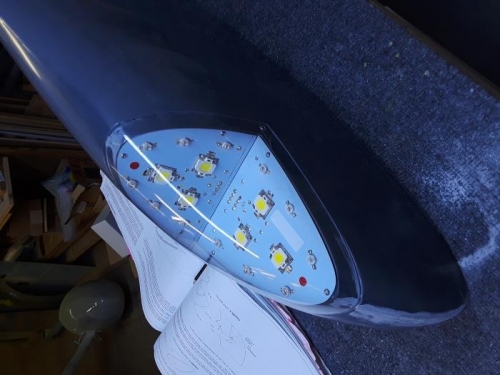

I trimmed the right-wing tip and match drilled to the wing skin. I fitted the tip to the wing and trimmed the aileron gap. The wing tip lens was fitted with nut plates added to fasten the lens.

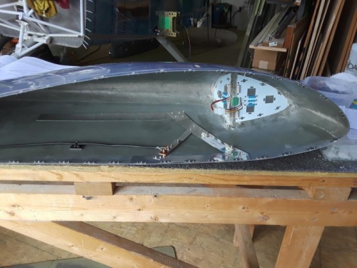

I installed the wing tip strobe and position lights.
I finished the wing tip with the installation of the trailing edge rib.
