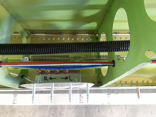

The electric aileron trim installed into the right wing. The servo attaches by springs to the aileron pushrod at the most inboard access panel.
The assembly is built up out of components and riveted together. The servo position is centered, the springs are stretched out 6 inches in each direction, and clips are pull riveted onto the push/pull tube for the aileron.
trim servo installation

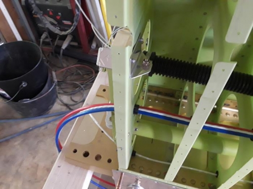

bracket to capture wire conduit

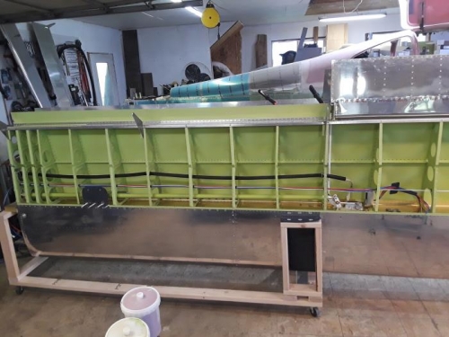

overall right wing wiring and pitot plumbing
