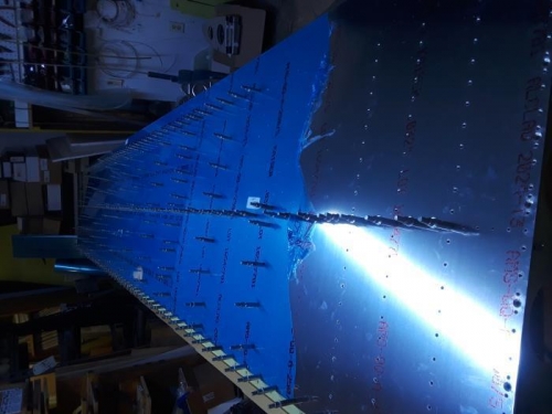

Brief Description:  Top skin left wing
Clecoed the top skins on the left wing, drilled, countersunk, deburred and dimpled.
Wow, that is a lotta holes
After riveting for hours, I counted the number of rivets in the top skin .... 1450 Of the 1450 there were probably 5 that I messed up. It is easy to get complacent after 100 rivets letting the bucking bar slip. I am guessing I have about 12 hours into the rivets on the left wing.
Hopefully the bad spots will be ok with a little filler prior to painting.

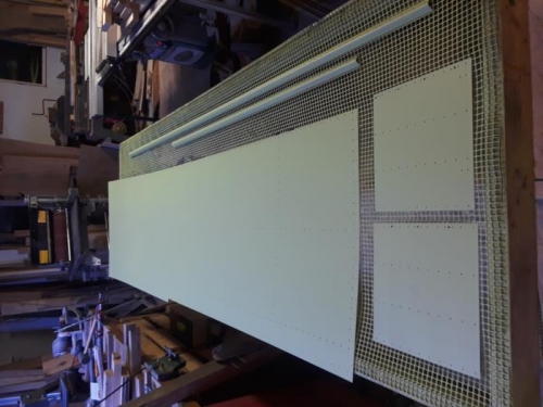

Clecoing on the bottom skin
Priming the bottom skin
