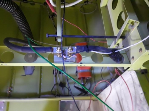

Brief Description:  Battery Shunt
I added in the battery shunt. I installed this in the rear on the main battery ground to measure charge/discharge of the battery. After installing the shunt in the rear by the battery, I realized I could have shortened the sensing wire by installing the shunt in front near the forest of tabs. Not a big deal since the sensing wire was easily pulled through existing conduit and at 24 gauge shielded, might weigh a few grams at most.
Battery shunt in rear on maim ground cable
