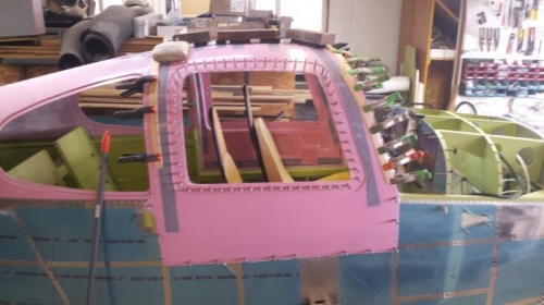

Brief Description:  Bonding the inner and outer door
I wetted the parabeam by placing the pieces between two sheets of plastic food wrap and rolling. Peel off the plastic and set into place, no mess, no fuss.
I mixed 75 grams of epoxy for that task. perfect amount.

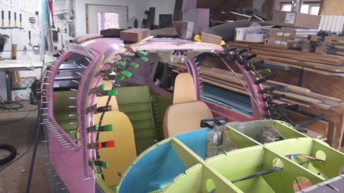

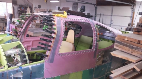

It took 200 grams of epoxy cab-o-sil mix to cover all of the bonding services. I clecoed, duct taped, clamped and weighted the doors to cure.
weighted on top
weighted on top
more weights
more weights
and yet more
and yet more
