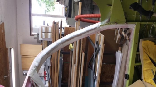

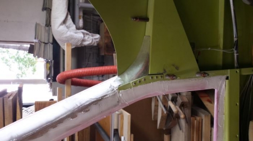

Brief Description:  A pillar closeouts installed
As a break from all of the wiring, I closed up the A pillar with the trim covers I made some time ago. I floxed in the rear edge leaving the front edge free. This is so I can tuck in the cloth wrapping when it is applied. I used micro to blend the rear edge. I also used the left-over micro to clean up the cabin top install and start cleaning up the flushness of the doors. Sanding as usual made a mess of everything.
micro before sanding
another view
