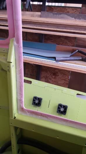

Brief Description:  Final canopy top installation
With the trim rings completed, it is time to install the canopy top permanently.

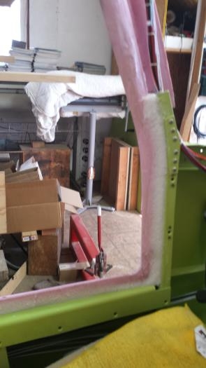

I ran both lines of pull rivets on the bottom of the canopy top. All of the screws and bolts are in and snug. I ran out of 8-32 lock nuts, and have them on order. Floxing the gaps is next.
The 8-32 lock nuts came in and are installed. The flox is in.
bloted and floxed
bloted and floxed
rear section
rear section
