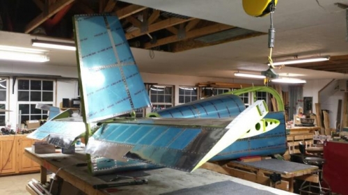

I have made a little progress on the RV-10. I was finaly forced to move my GP-4 fuselage out and into storage. The shop reorg and cleaning added about 8 hours that I will not count towards the build. The pieces of the RV-10 are getting too big. The stabilizer and vertical stab are attached and as close to perfect as I can make them. I put some pretty good dings in the Vert Stab now that I look at it again, and may decide to build another one. I'll talk to an EAA Tech Counseler about possible repairs such as filling etc..

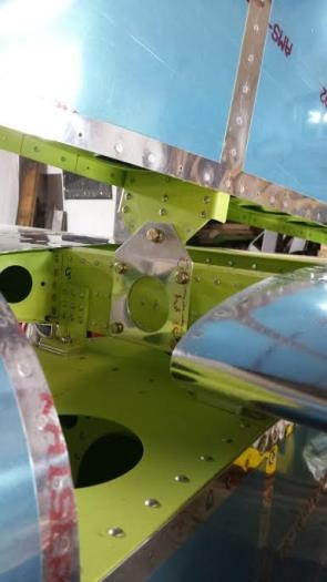

critical bolts
critical bolts

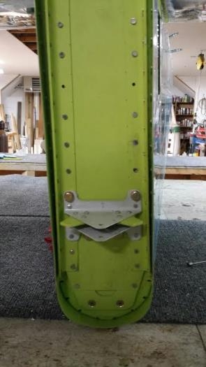

elevator attached
elevator attached
rear view of the vertical Stab
