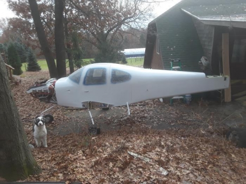

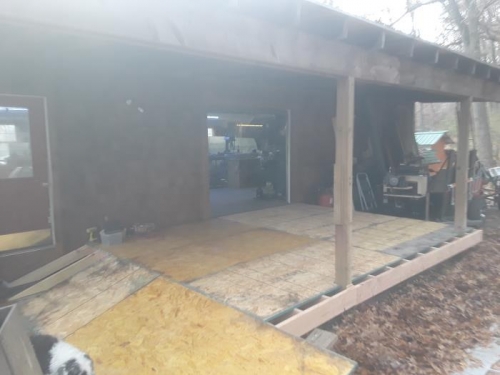

I rented a hanger on November 25th and moved the fuselage the next day. It was a big day rolling the fuselage out into the yard. It fit through my shop back door with the wheels brushing the door frame. I also had to build a temporary 12 x 16’ deck with a ramp as there is an 18” drop as you go out the door. The fuselage needed to make an immediate right 90-degree turn, which took a lot of back and forth to clear all of the obstacles. I welded up a tow bar from spare 4130 tubing I had on hand from my GP4 project. I also managed to drive a sharp scrap of aluminum into the front tire that I missed in all of my sweeping giving me a flat tire. So, now I have experience repairing a flat tire on the plane.
My son Tim and son’s friend (with 24-foot goose neck trailer) helped out making the move easy. Overall, the move went off without a single problem outside of the flat tire.

Deck and ramp to exit the shop
Oitside for the first time
On our way
On our way
