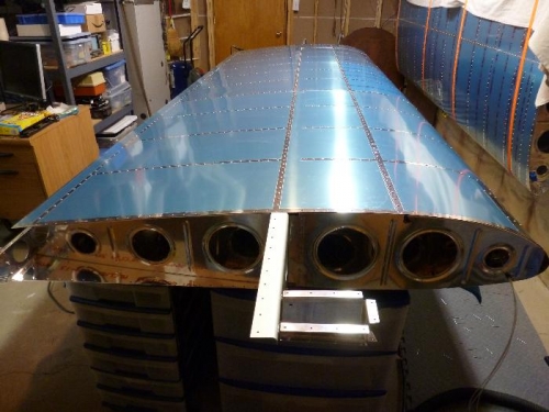

Brief Description:  rivet right wing top skins, add wing hold & rib
17-04 steps 3 and 4. Complete right wing top skins.
17-05 steps 1 and 2. Deburr and rivet W-1204G-R wing hold and W-1213-R tip rib.
Had to take 0.33 hours to adjust the pneumatic riveter. One rivet did not work correctly which left about 1/16" of the shaft exposed. Filed this down to the factory head.
right wing top skins done

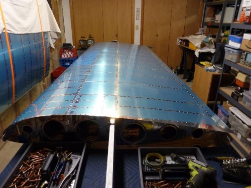

right wing tip hand hold
