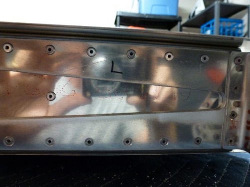

Brief Description:  prepare W-1201C-L, mod rear spar rivets
Prepare W-1201C-L wing walk, deburr and dimple and test fit 1.25 hours
1.25 hours. See 14-03 notes in my plans. Modify bottom row and 3 up from bottom on the left rear wing spar doubler W-1207B inboard end. Replace surface rivets with CS4-4 flush rivets. This is done to avoid possible interference with flaperon. This was done per suggestion by Scott Malcomb (RV-12 builder, Eagles Nest) at Oshkosh 2014 and Vans Aircraft email. See picture of finished mod. Here is body of email from Vans to Scott approving the mod:
> From: "Joe Blank"
> Date: November 6, 2013 at 1:54:04 PM EST
> To: Scott Malcomb
> Subject: Re: RV-12 - Section 39
> Scott,
> I ran the issue by both Van and Rian here. Both agreed that the offending rivets could be replaced with CS4-4 rivets to alleviate the interference issues. The rivets are predominantly in shear to the head shape should not affect the strength much.
> Another possible fix would be to lightly file the heads to remove any rough edges.
> Best Regards,
> Joe Blank
> Airshow Coordination - Builder Support
> joeb@vansaircraft.com
> www.vansaircraft.com
> 503-678-6545
repaced to flush rivets
