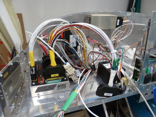

Brief Description:  Many items related to the avionics installation
Manual 42C-02 step 3 install WH-00020 harness to EMS & AV50000A and mount remote USB connector. Had to file out the hole a bit for proper fit.
Manual 42C-03 steps 1-4 connect WH-00025 AP harness, route wires through the bottom of the instrument compartment and attach connector. Wish I had waited to add connector until finishing the AP instalation because now the pins have to be removed and a different wiring is done.

Manual 42M-02 step 3 install "options" connector to the AV-50000A.

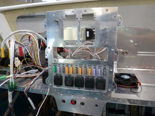

Manual 42M-03 step 1 inslall fuses in the AV-50001 power switch module.
Manual 42M -04 step 2 & 3 mount the AV-50001 power switch module in the center instrument panel and mount the panel to the center area.
Manual 42M-05 steps 1& 2 connect the dimmer potentiometer pins in the switches connector and mount the pot in the center panel.

center panel mounted
wiring details
wiring details
