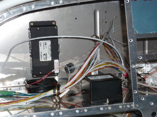

Manual Reference:  42C
Brief Description:  install EMS and Battery modules
42C-02 steps 1 & 2 install the SV-EMS-220 and the SV-BAT-320 backup battery. Added three washers the the forward battery module mount because I had difficulty tightening the mounting screw all the way without it. Still have 2 threads showing through the nut.
EMS and backup battery
