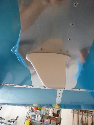

Number of Hours:  1.75
Manual Reference:  53-11
Brief Description:  install ADS-B antenna

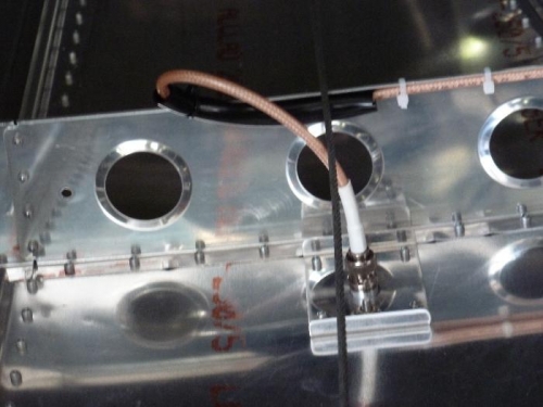

Manual 53-11 steps 1 - 5, drill holes for antenna doubler and antenna. Install antenna and connect the coax. Torqued the antenna screws to 20 In/lbs per the instructions with the antenna. Made note to check clearance of the coax with the control cables once they are connected and tensioned.
ADS-B fin antenna
ADS-B fin antenna
coax and antenna doubler
