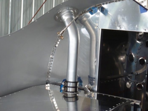

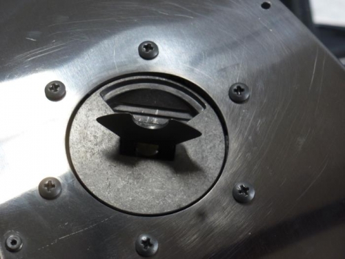

Manual 37-09, reinstalled the fuel take after completing the SB 00053 work. Installed the filler neck, used fuel tank sealant, etc. Placed the fuel cap on.

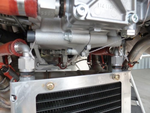

Used safety wire to temporarily hold the oil cooler while the bottom cowl is not installed for the first engine start.
