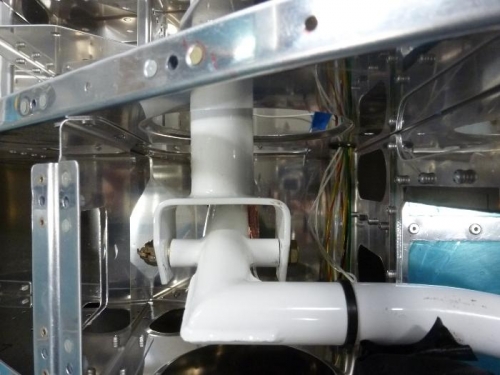

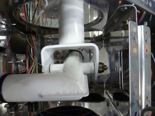

Brief Description:  Polish and attach control stick bushings
Manual 32-05, step 4 & 5 completion - polish the inside of the control stick tube and the brass bushings that slip inside for a more friction free fit. Applied some Boelube to the brass bushings. Inserted them and bolted together. Did not torque do to castle nut. Had to add a washer on the bolt head side for proper spacing to occur for the cotter key to work with the castle nut.

right side control stick
left side control stick
