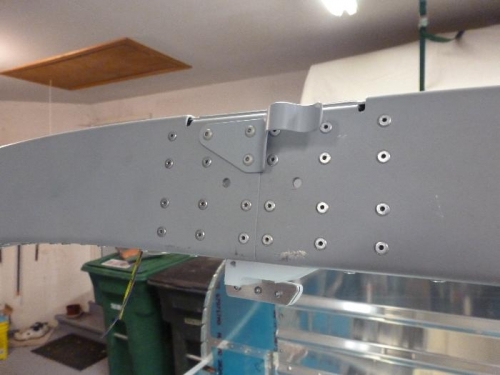

Install canopy catch option
Manual 34-25 steps 1 - 5, (and Notification 16-10-3) drill out three rivets and install extra canopy catch. Adjusted as needed. Polished the catch and primed before imstall, did not paint.
canopy catch
