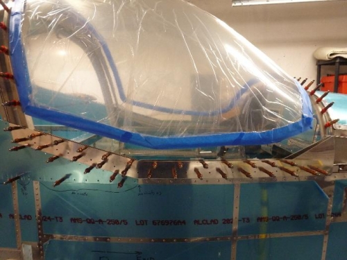

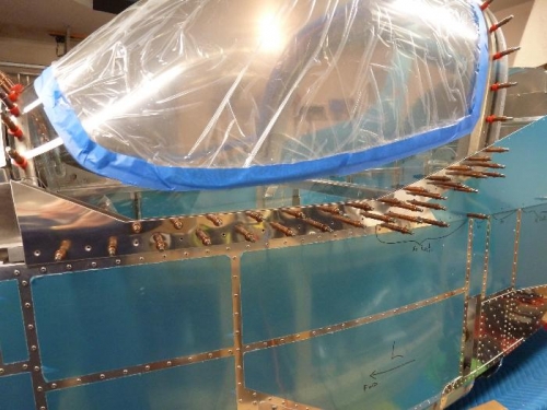

Brief Description:  match drill skirt holes to canopy and frame angles
Manual 34-07 steps 1 - 2, match drill all holes in skirt left and right into the canopy and the canopy frame angles inside. Did not use a helper on the inside of the canopy as per instructions because it was easy enough to do by myself drilling from the outside. Everything stayed in place. All holes now drilled in the canopy as required!
left side
left side
right side
right side
