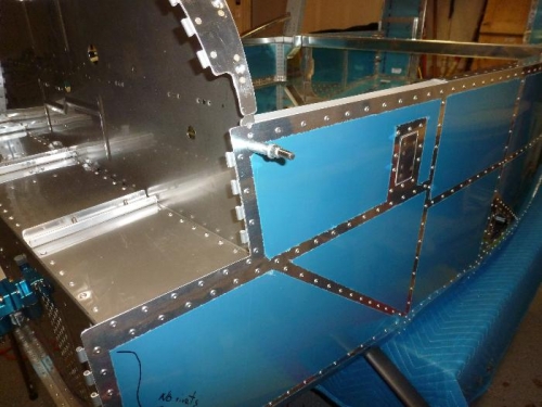

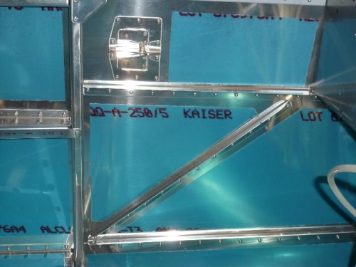

Manual 29A-03 steps 2 - 6, attach mid-cowl hinges, attach fuselage stiffeners. Note: had to drill out two LP4-3 rivets on each side to install horizontal stiffeners. There should have been notes in the plans to keep these rivets open.

left side mid-cowl hinge
left side stiffeners
right side stiffeners
