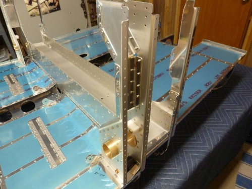

Brief Description:  Install left and right forward bulkhead side assys
Manual 21-08 steps 1 - 5, rivet the forward side bulkheads, rivet the bulkhead caps to both the left and right sides and install wing spar support rollers.
Note: I shortened the right roller slightly to allow the bolt to be torqued and still allow the roller to rotate freely. Left did not require mod.Torqued both AN3-24A bolts to 30 in/lb and applied torque seal.
right side bulkhead
right side bulkhead

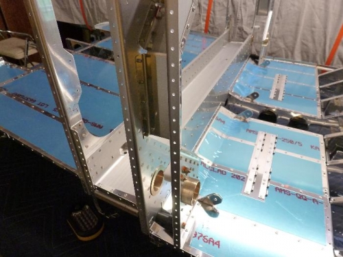

left side bulkhead
left side bulkhead
