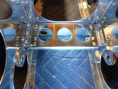

Called Gus at Vans Aircraft at 9:10 am. He verified that the remainng open holes in the bearing brackets must have the rivets installed per the plans. The SB 14-12-06 does not cover this.

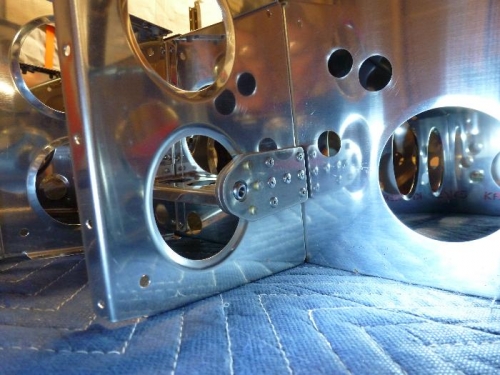

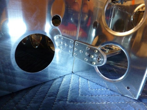

Installed four LP4-5 rivets per side on bearing brackets per 21-03 figure3. Took new pictures.
left bearing bracket all rivets
right bearing bracket all rivets
