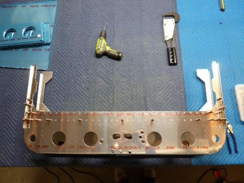

finish match drill, countersink center fuse assy.
Manual 20-03 step 2, finish match drilling #30 and #11 in F-1204 center section assembly.
Manual 20-03 steps 3 and 4, deburr all F-1204 and F-1204D. Countersink F-1204.
Manual 20-04 step 1, attach F-1204P-R & L skin attach flanges to F-1204 center section assembly.
Manual 20-04 step 2, rivet LP4-3 only on F-1204, F-1204D and F-1204F-R & L.
fifinished match drill
