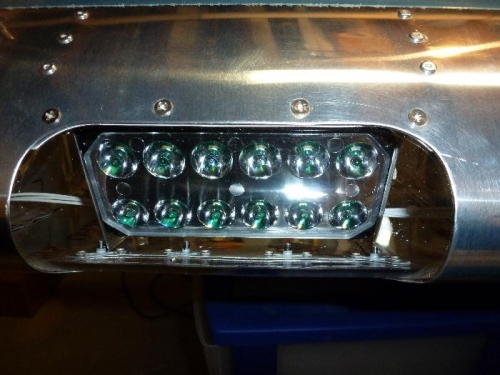

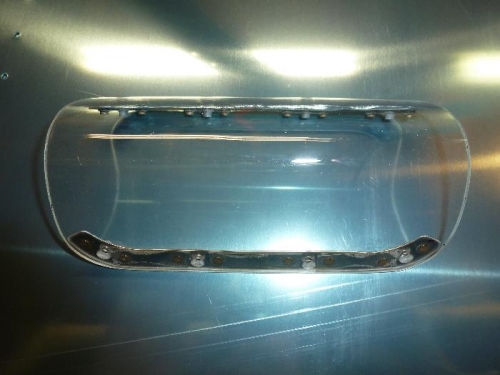

Brief Description:  finish landing light lens and mounting light assem
Manual 40-03 steps 5 - 11, finish landing light lens. Used band saw to rough cut the lens. Cut very slowly and it worked great. Used sanding disc on drill clamped to bench to final sand the lens. Finish with 220 sand paper by hand. Very pleased with the results.

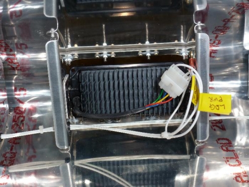

Manual 40-07 steps 8 & 9, install lens into wing, fit very well. Then re-installed the landing light assembly.
This was much easier to install while the wing is still open. Landing light completed!
landing light lens assembly
landing light completed
back side wiring landing light
