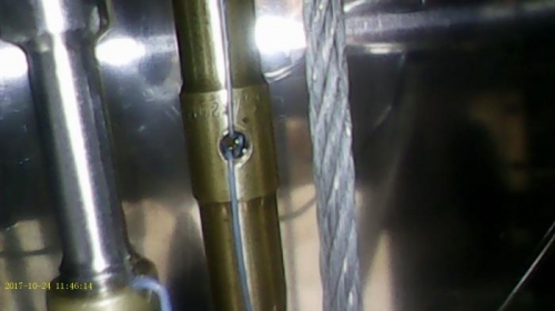

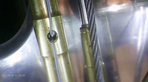

Rechecked the horizontal stabilator cable tensions. Used Kent-Moore BT-33-750 cable tensioner for readings on the 1/8 cable scale.
Manual 32-14 step 8 inserted the locking clips into the turnbuckles. Made sure they are in and locked and took close-up pictures to verify.

clips locks in-place
clips locked in-place
