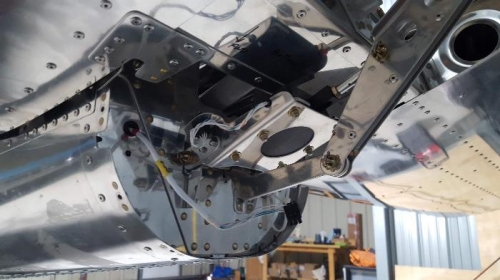

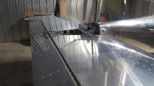

Manual 11-03 step 3, torqued the two stabilator hinge bolts to 60 in-lbs.

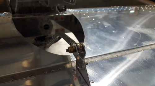

Manual 11-08 steps 8 - 10, install the trim servo assembly onto the empenage and the trim tab. Installed the cotter pin on the servo to empenage connection and toqued the sevo to trim tab hardware to 30 in-lbs.
All movement is free. Will check tolerance further per manual instructions.
trim servo assy installation
trim servo connection to tab
view of stab with trim servo
