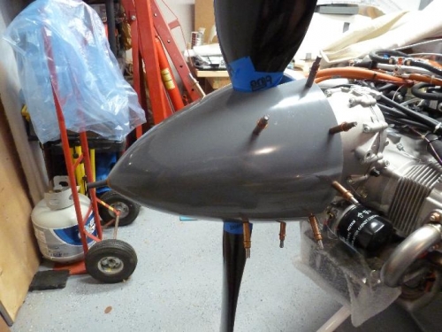

Brief Description:  finish spinner while mounted
Manual 47-03 step 7 finish pitching blades to #3 per Sensenich pitch guide tool. Step 8 mask the props and mount and clamp the spinner

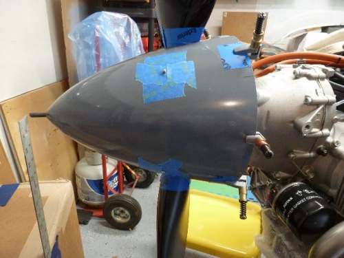

Manual 47-04 steps 1 - 3 check squareness of the spinner mounted to less than 1/16" variance. No adjustment needed.
Manual 47-05 step 1 and 2 match drill the spinner to the holes in the spinner plates. Used magnetic balls taped to the holes on the plates then another magnetic ball on a fiber washer to position the holes on the spinner. Taped the washers in place then remove the ball and match drill #30.
